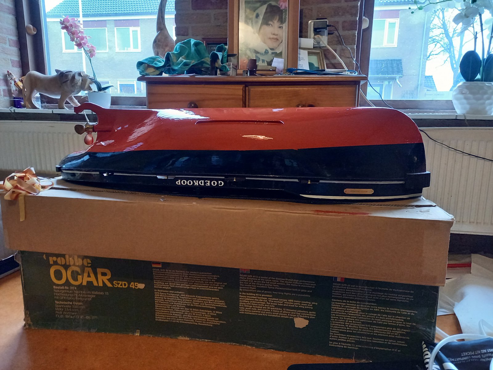

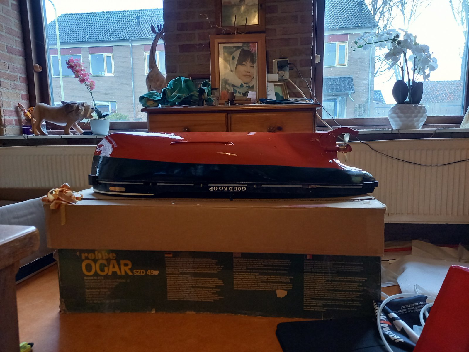

« Reply #51 on: March 24, 2024, 05:28:24 pm »
  Paint or Hull crack? ....  :((
Paint and maybe the bondo, but the wood is intact as far as I can see...
But despite sanding down, the cracks kept sucking up paint.
So I applied a first pretty heavy coat, kept the cracks "wet" with paint for a while, and after 2 hrs applied a 2nd heavy coat, and the 2nd coat the cracks did barely draw in any paint.
With a bit of luck it'll be allright. If it isn't, I'll have to gouge out the cracks and fill them with 2 component glassfilled bondo.
While I was at it, I corrected the horribly misplaced "waterline".
Not bad, even if I say so myself.

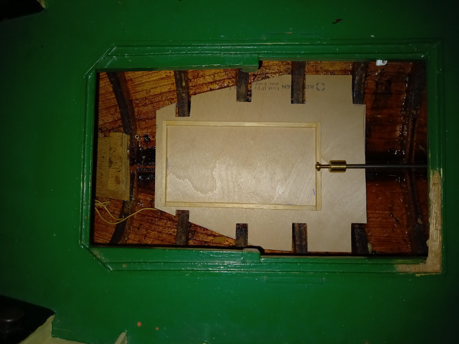

OK... the ignition parts landed this morning, so they could be on my doorstep as early as Tuesday (but probably not... :p ).
So I need to get the testbed ready...

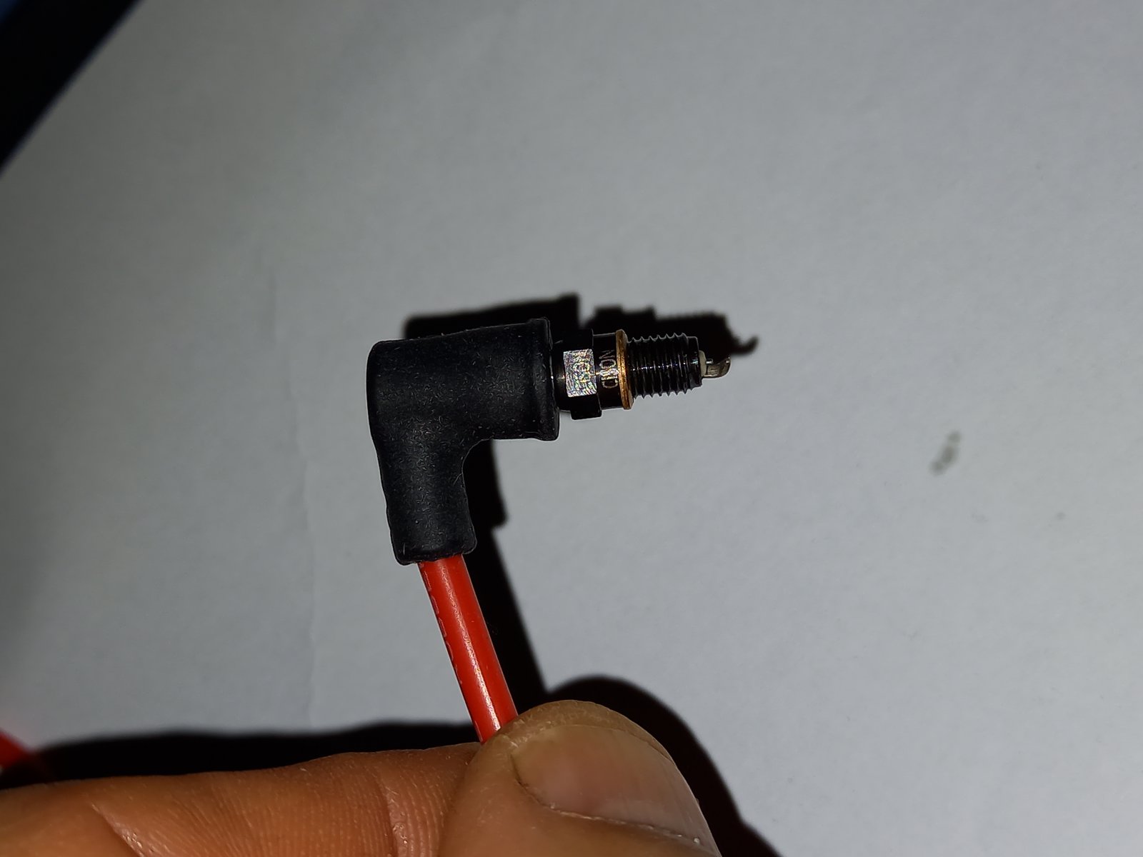

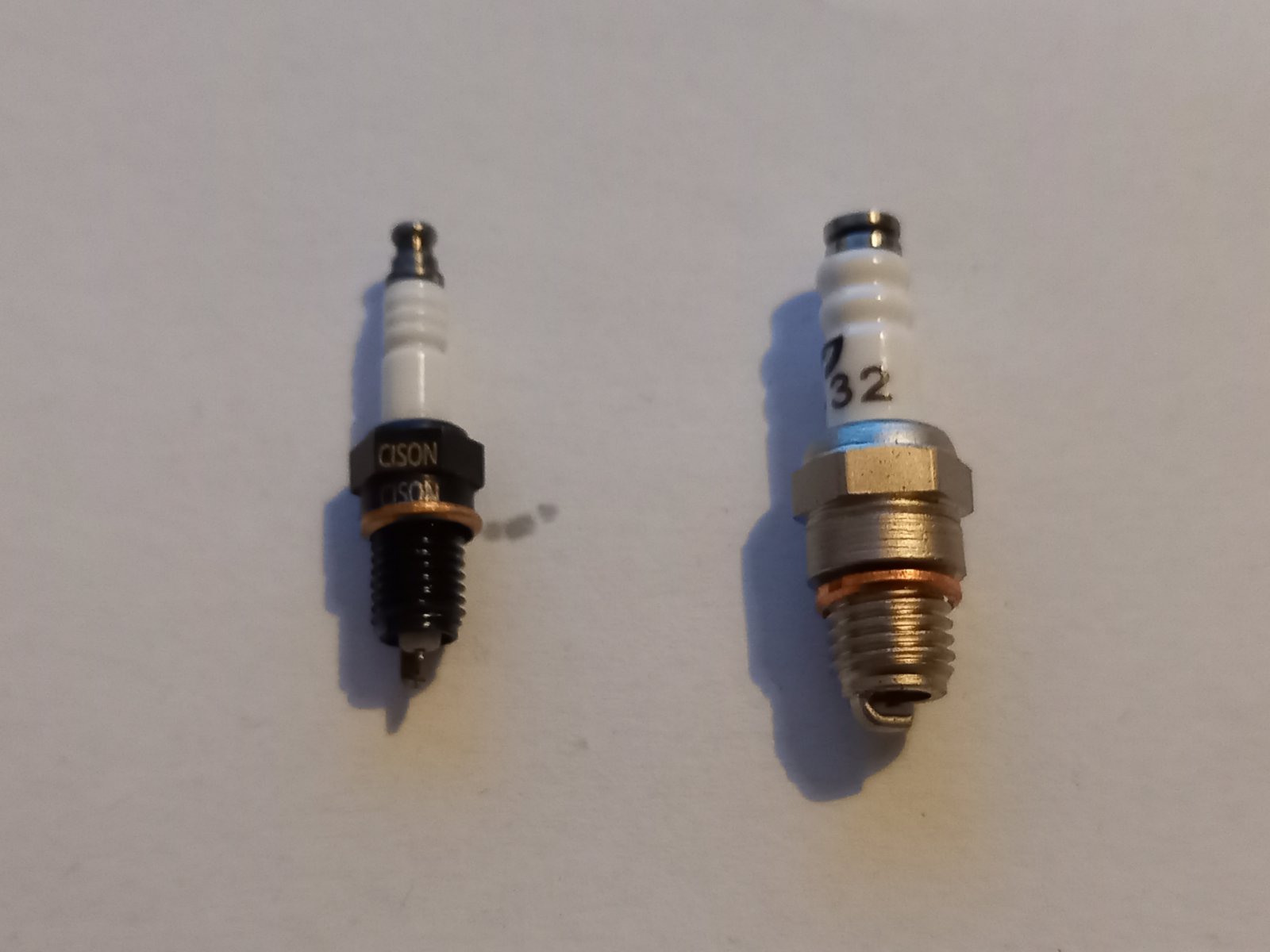

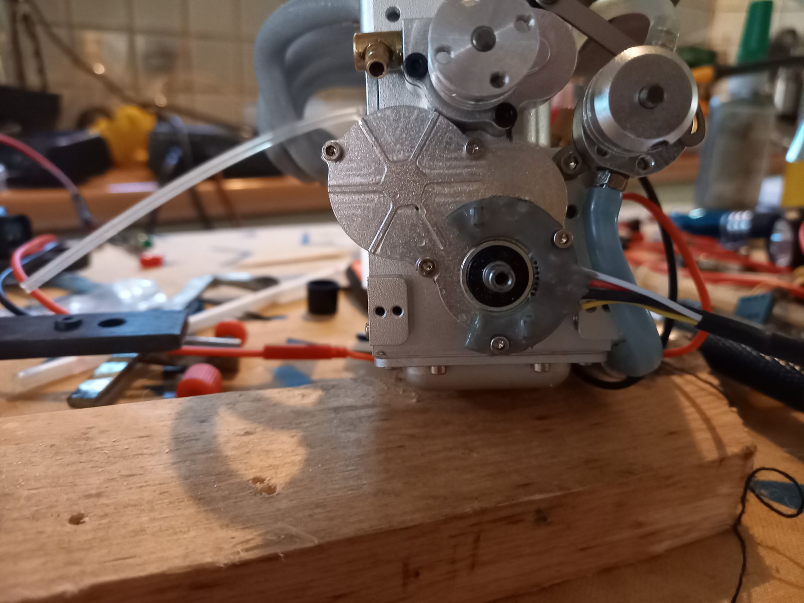

First of all those elusive tiny sparkplugs...
For those of you guys familiar with glow engines: On the right is a sparkplug in the standard thread for glow-engines (1/4"-32) and on the left is the amazingly tiny things this engine requires...
The nasty thing was that the kit as received, still basically was intended for the "large" sparkplugs In fact, it was a kit containing 4 large plugs, and the new smaller plugs were added in. Have to hand it to them chinese, no extra cost so I have 4 plugs 1/4"-32 for free basically), so the rubber caps supplied were loose on the new tiny plugs.

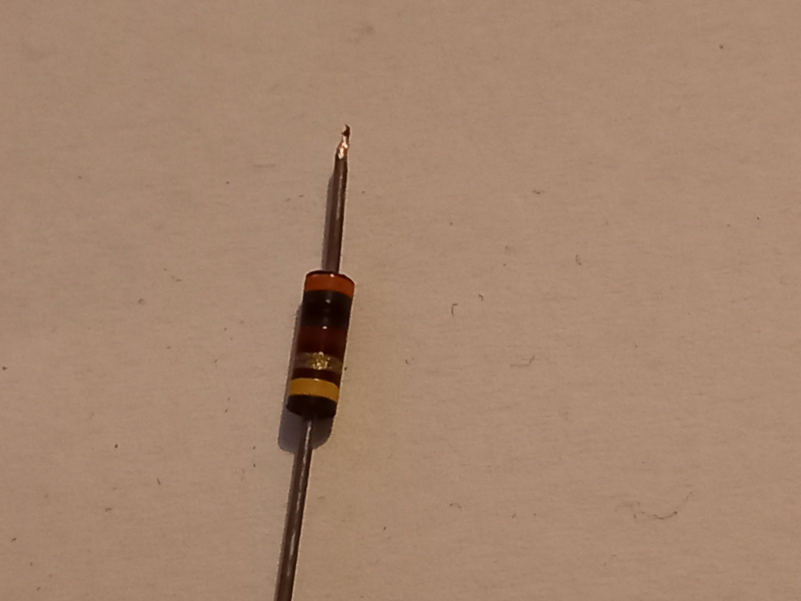

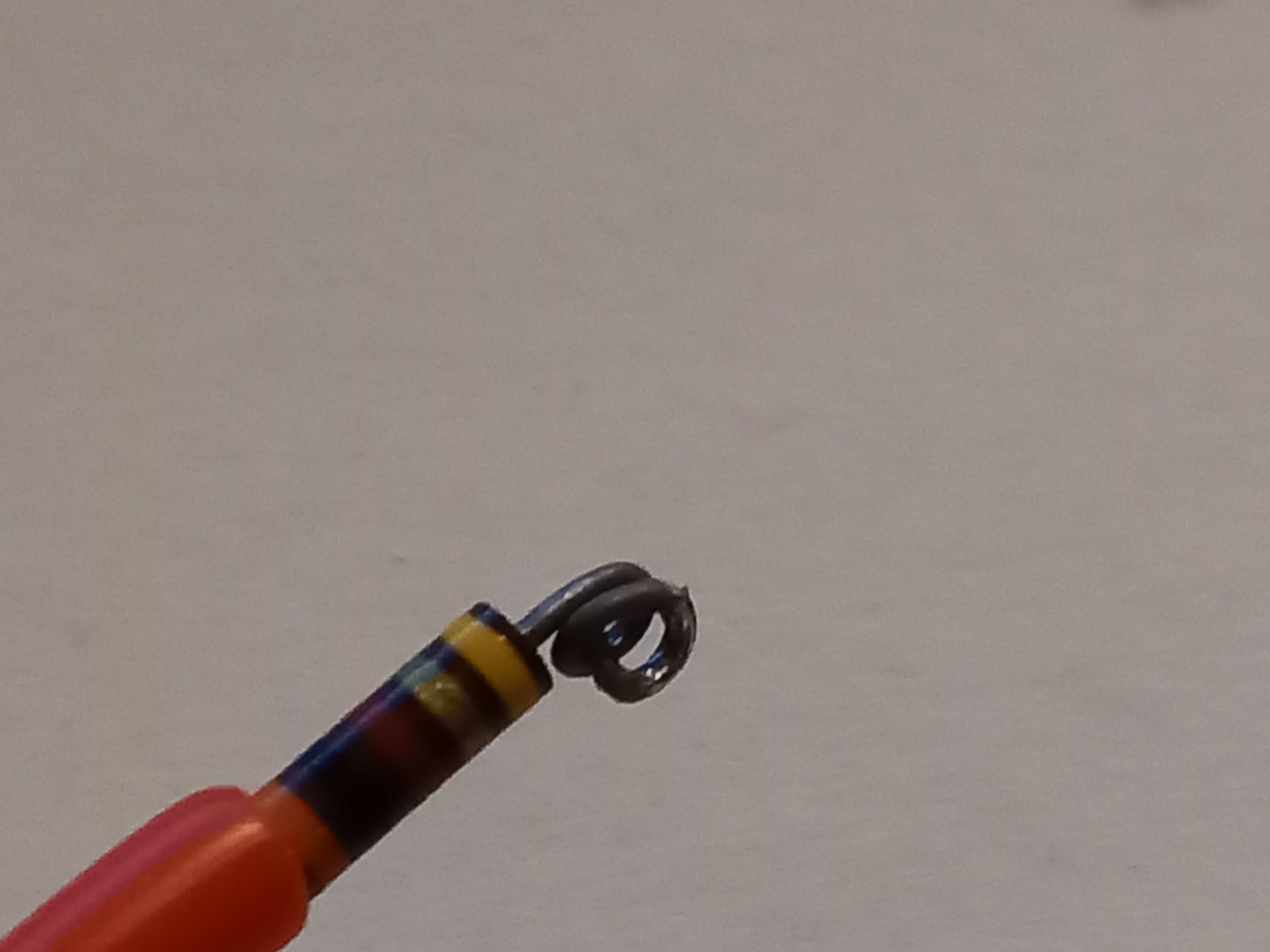

Also, for RF supression, 4 resistors 5K were supplied. Regular resistors, and how you want to install them is left to the imagination.
So here's what I did:

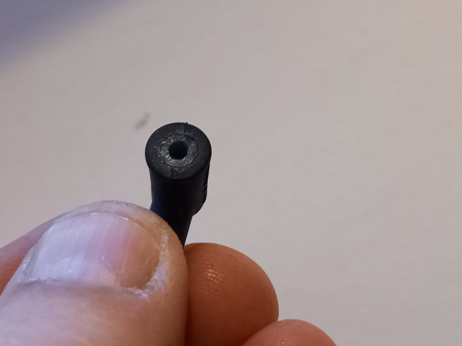

I cut one of the pins to half length, and ground it sharp using the Dremel.

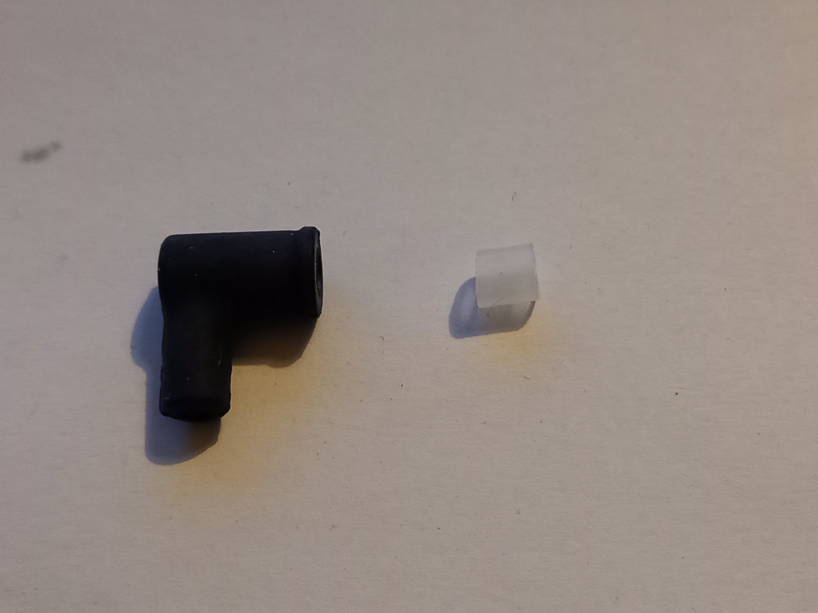

This sharp end is stuck in the end of a HT lead
The other pin is coiled up using a small needle-nose pliers
Now I cut about 5 mm of silicone tubing (3 mm inner dia, 1 mm wallthickness) to make the plugboot fit snug on the porcelain of the plug, and stick everything together.
Now I had the issue, that the instructions (not supplied with the ignition kit, but on the vendor's website) still mentioned a ground cable, but this info was valid for a previous version. The new version did not have a groundcable, but silly me, it took me a day to figure out HOW that would work, and why.
Since I am slightly autistic (fo'realz) I did not dare powering up the ignition until I was sure I would not blow up the Hall sensor arrangement.
Next step was fitting that arrangement on the engine, and I've got to say, this all went together perfectly. Pretty nice design!
I was initially dissapointed that Cison does not use the RcExl (another chinese manufacturer of Model engine ignitions) standardized connectors, because I have a timing gadget for that brand...
But to my great surprise, the Hall sensor arrangement was fitted with LEDs, so this thing really is a doddle to set the timing right.

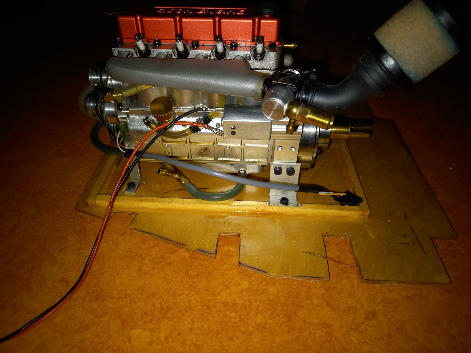

Soo yesterday evening, I mounted the engine on my teststand, with just a tank for the coolant, no radiator yet (I have one, supplied in the ignition/starter kit) because that radiator has connections totally different from the connections supplied with the engine. So I have to first figure out how to fix that.
But I was guessing it would take a minute or two to warm up 250 ml of coolant, so for short runs, no problems.
Well... No more beating around the bush, no more delays:
https://www.youtube.com/watch?v=-GnA-3U9ap8

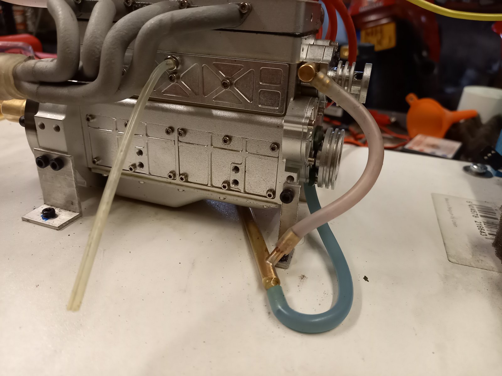

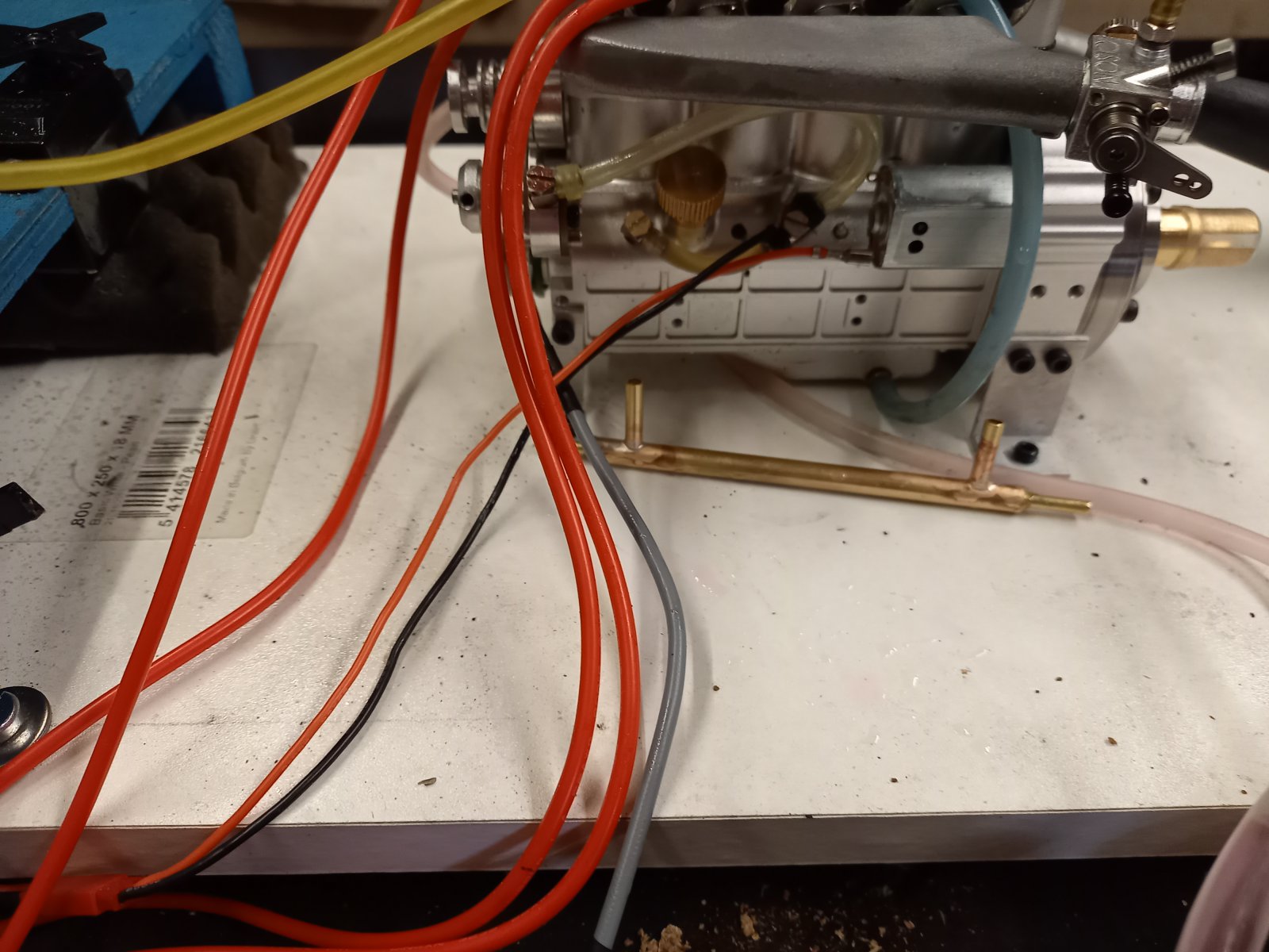

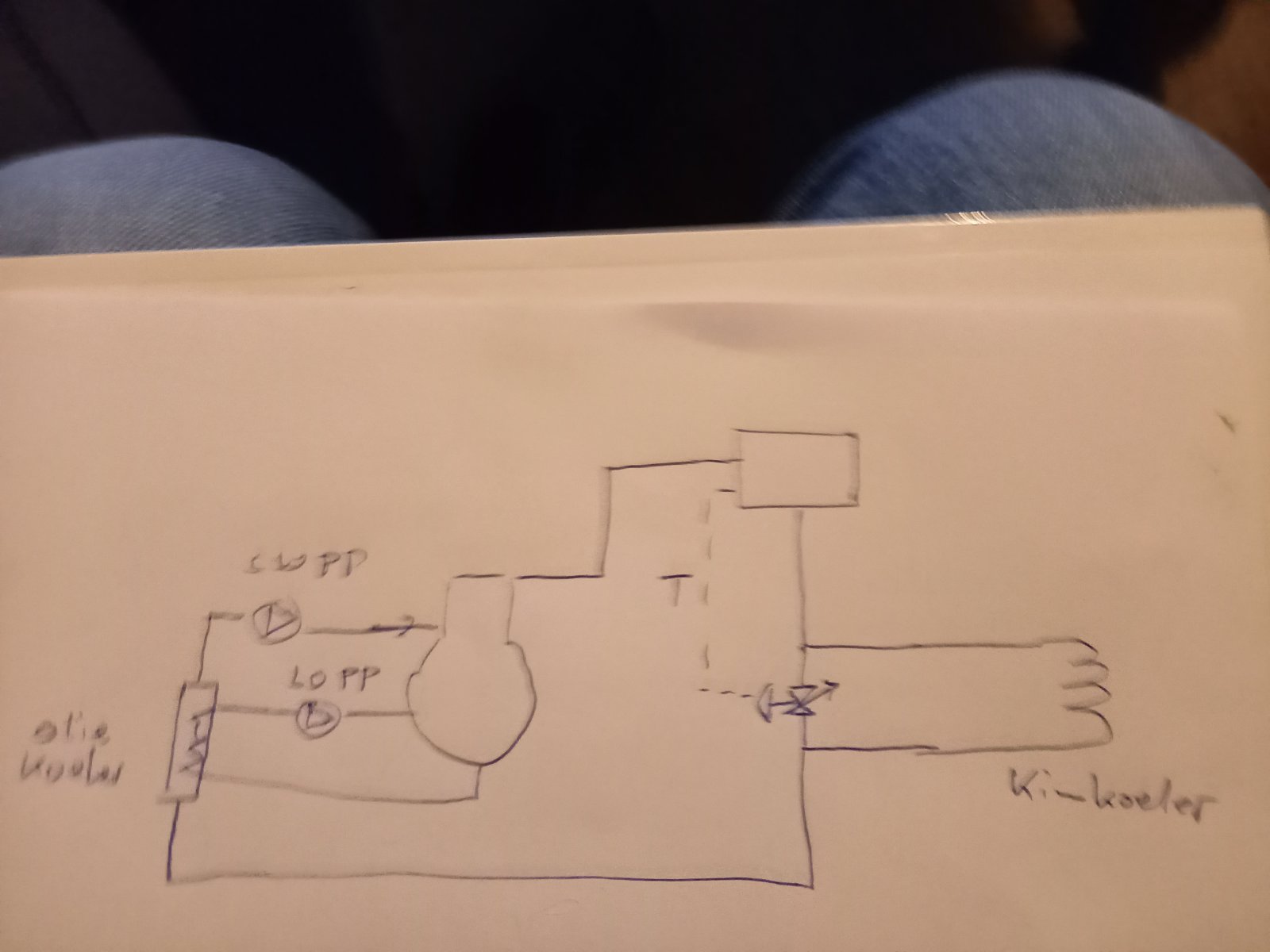

Since I cannot run the engine due to lack of "belts", and I had to do something due to lack of a better thing to do, I wasted a little bit time on an oil cooler of sorts.
I do not have the faintest clue it would need one in the first place, but given that virtually anyone running this engine is is either running it on the bench (no load whatsoever, or in a car model (exposed engine, air flow when at speed), but my application is in the enclosed space of a boat hull, I can imagine that there is very little empirical information availlable about oil temperatures and such.
The thought was that if it won't help, it won't hurt either, so first a little bit of figuring out how to arrange it, I came up with this:
Temperature controller is trying to keep enigne outlet temp constant, so increasing load will result in lower inlet temp.
I can select the coolingwater pump speed, so I can determine the range of inlet temperature (this is a fixed setting to be determined on the testbed)
By connecting the LO cooler in series before the cylinder block, and optimizing the waterflow through the engine, theoretically the oil temperature will also be around that range. It won't get colder than the cooling water inlet temperature, and it won't get much hotter either.
What is more: At increasing load, the inlet temperature is lowered by the temperature controller, so oil cooling is "controlled" without adding a 2nd control loop.
Again: No idea if it is needed, but it is just fun in itself figuring out stuff like this.

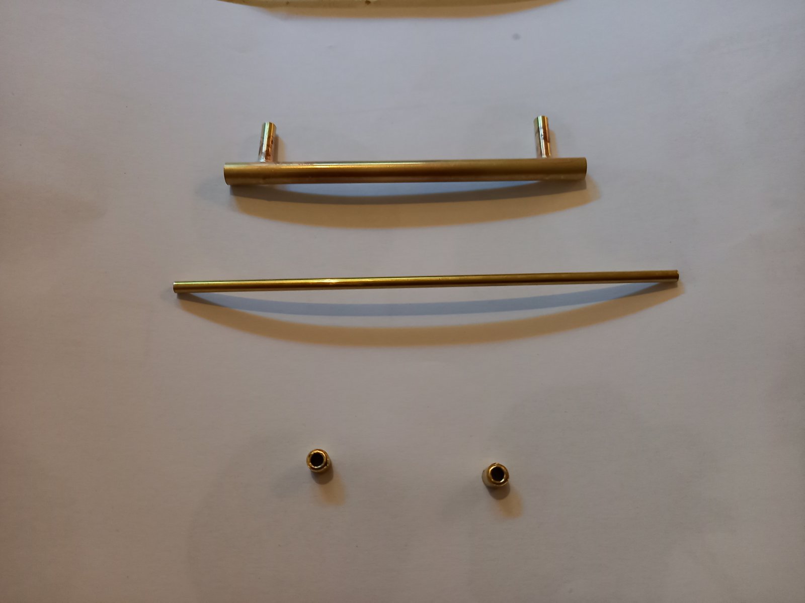

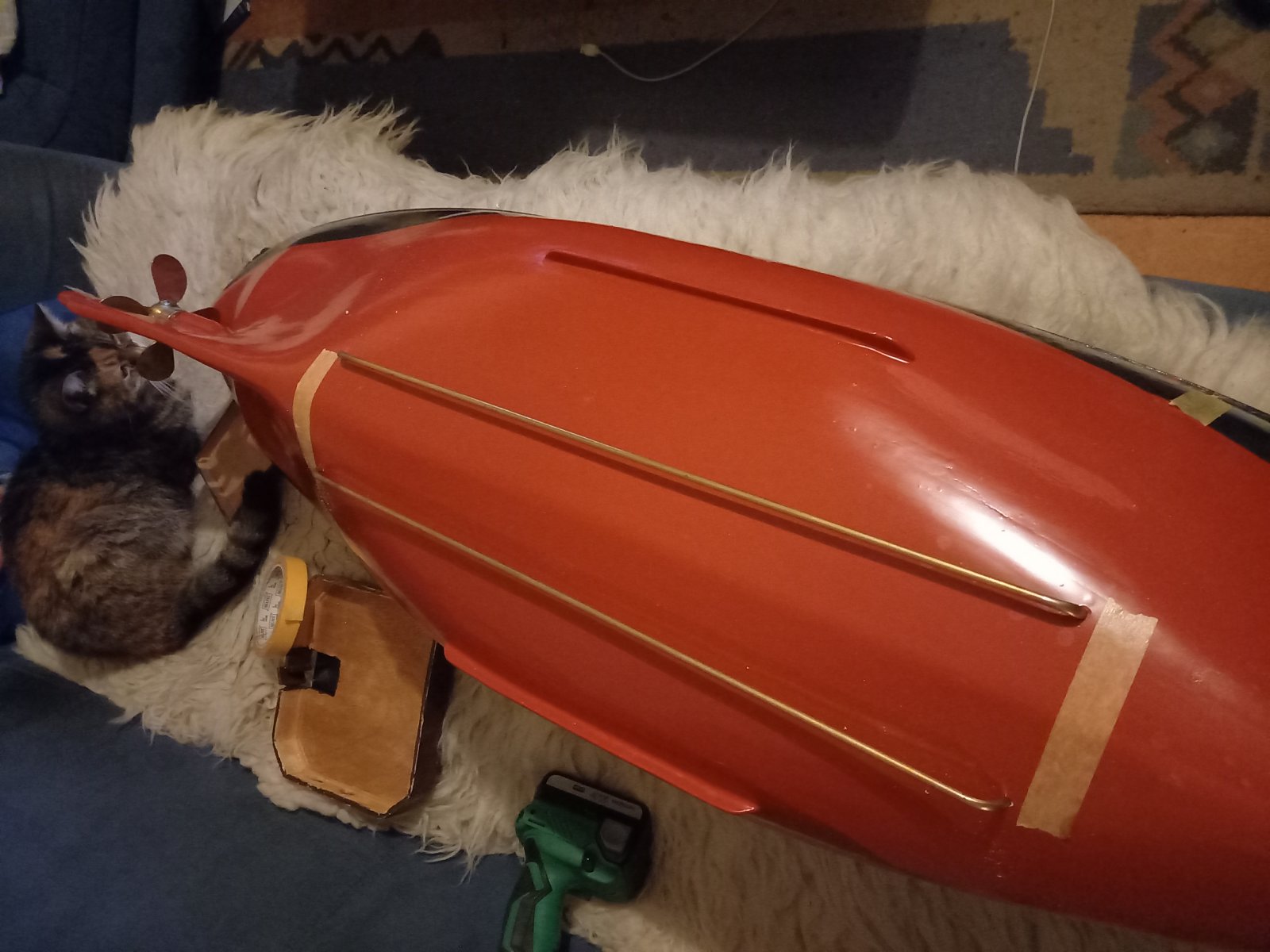

So I bought some brass tubing 6, 5, 4 and 3 mm OD, wall thickness 0,5 mm.
The outer shell is 6 mm tubing, the oil tube is 3 mm (2 mm ID like the rest of the oil tubing), the water connections are 4 mm OD (so 3 mm ID like all the coolingwater tubing) and the "bulkheads" are short rings of 4 mm and 5 mm tubing
The water connections are silverbrazed to the shell, the oil tube and bulkheads are Epoxied in with UHU Plus E300, oven cured.
In front of the engine for an impression of size:
And installed:
Cooling surface is approx 10 cm2

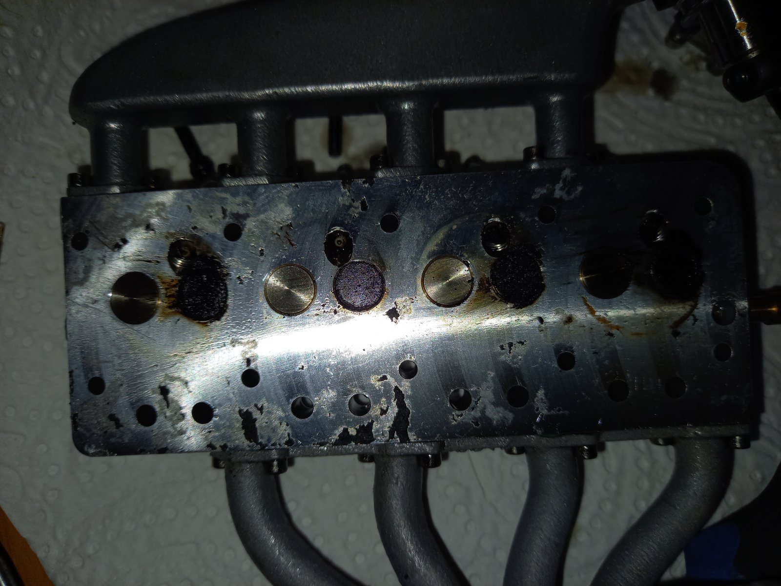

Yesterday I noticed that the delta-T was only about 8~10 degrees C and I can only conclude that the original belts, that were pretty stretchy and loose, allowed for some serious slippage on the pulleys. I see more signs of an increased waterflow, but they are circumstantial at best, not rock-hard proof or such...

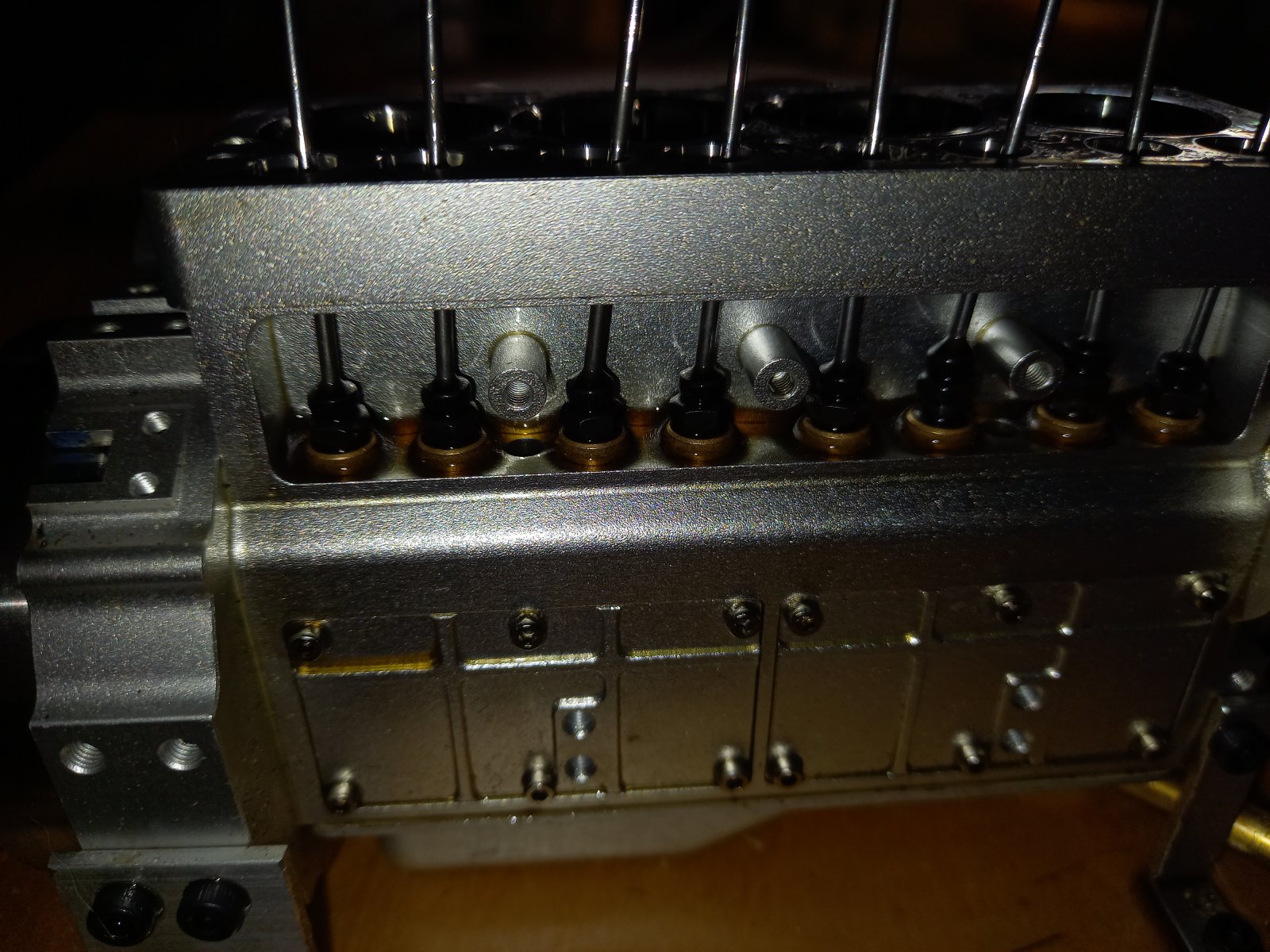

Also, something I noticd was that the reockerbox basically was only lubricated by the smell of oil, and I don't like dry moving parts.
So I thought I might be able to fit an oil gallery over the rockers. Measurement confirmed that there was 2,7 mm clearance between rockers and cover, enough to fit a 2 mm brass tube in the cover.
In this tube, careefully aligned to run directly over the fulcrum shaft, 4 tiny 0,8 mm holes were drilled, located centered above each pair of rockers. The oil will drip on the shaft and spread from there.
This would look a bit like this:
Oil supply was branched off from the main line, by silvrbrazing a "T" out of 2 cm of 3 mm tubing and 8 cm of 2 mm tubing. After brazing and quenching brass gets as soft as copper. So easy to bend the 2 mm line such that it connects with the oil gallery.
And if you look closely, when I pull the filler cap, you can see some oil flowing over the rocker arm, oil that was not there before...
Valve lubrication for CISON OHV L4-205 (youtube.com)

Well, the valve lubrication was a bad idea: Heavily smoking engine and rapid drop of oil level, so that idea can be discarded.

This project hibernated for almost 9 months...
Looks like slowly the drive is coming back:
A few minutes with a blowtorch annealing brass tubing, and a little bit free-hand bending gave me this:
And two minutes with the cordless drill resulted in this:
Now it's a matter of a few distance pieces, and a decent dollop of Epoxy, and they should be sealed up.
That's how you make bilge cooling... :D

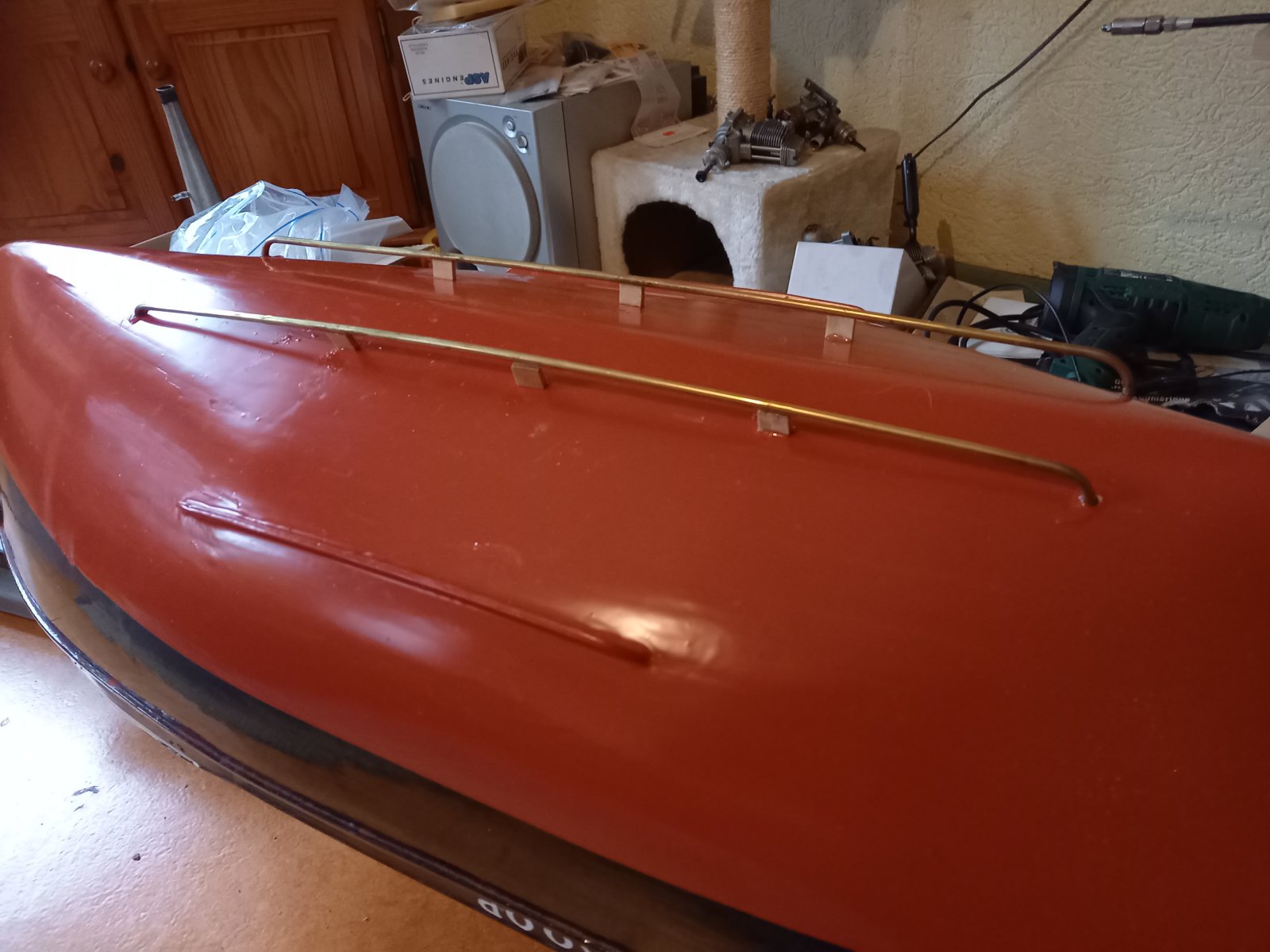

After a night of curing:
It is pretty difficult to keep the curing epoxy under control, so on close examination unfortunately a few big "blobs and sags" which I am hesitant to try and remove, worried that I might pull the paint off.
Right now, each tube is approx 43 cm (17") of exposed length, and at a diameter of 4 mm, that means a total exposed surface of about 105 cm2 or 16,5 sq.in.
At the amount of heat I expect to dissipate (I am guessing in the neighbourhood of 500W), and with water-to-water exchange, I expect this to be enough.
Possibly (but that ould be a real stroke of luck) close enough to function acceptably without temperature control

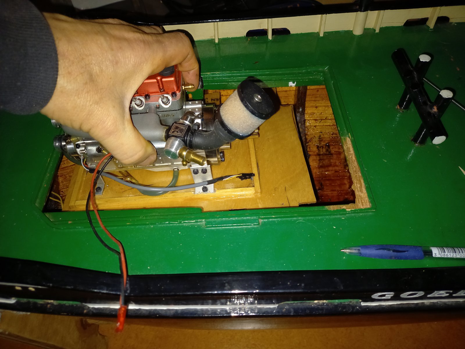

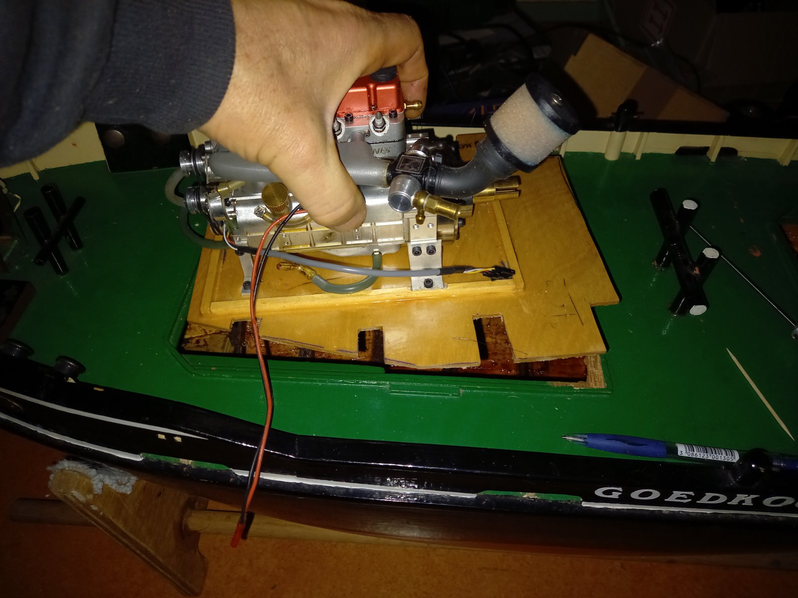

Floorplate with driptray, in case of oilspills (the tray should be able to easily hold the contents of the sump 2 times over with a margin).
1967Brutus
  • Posts: 589
Re: Gasoline powered Tugboat
« Reply #70 on: January 21, 2025, 08:56:41 am »
Yesterday, I brushed on a few layers of filler and 2 layers of Glitsa polyurethane floor laquer. "poured some over it" could be a better word...
This morning, a few holes drilled and a few insert-nuts on the underside, and voilá... An engine on its foundation!

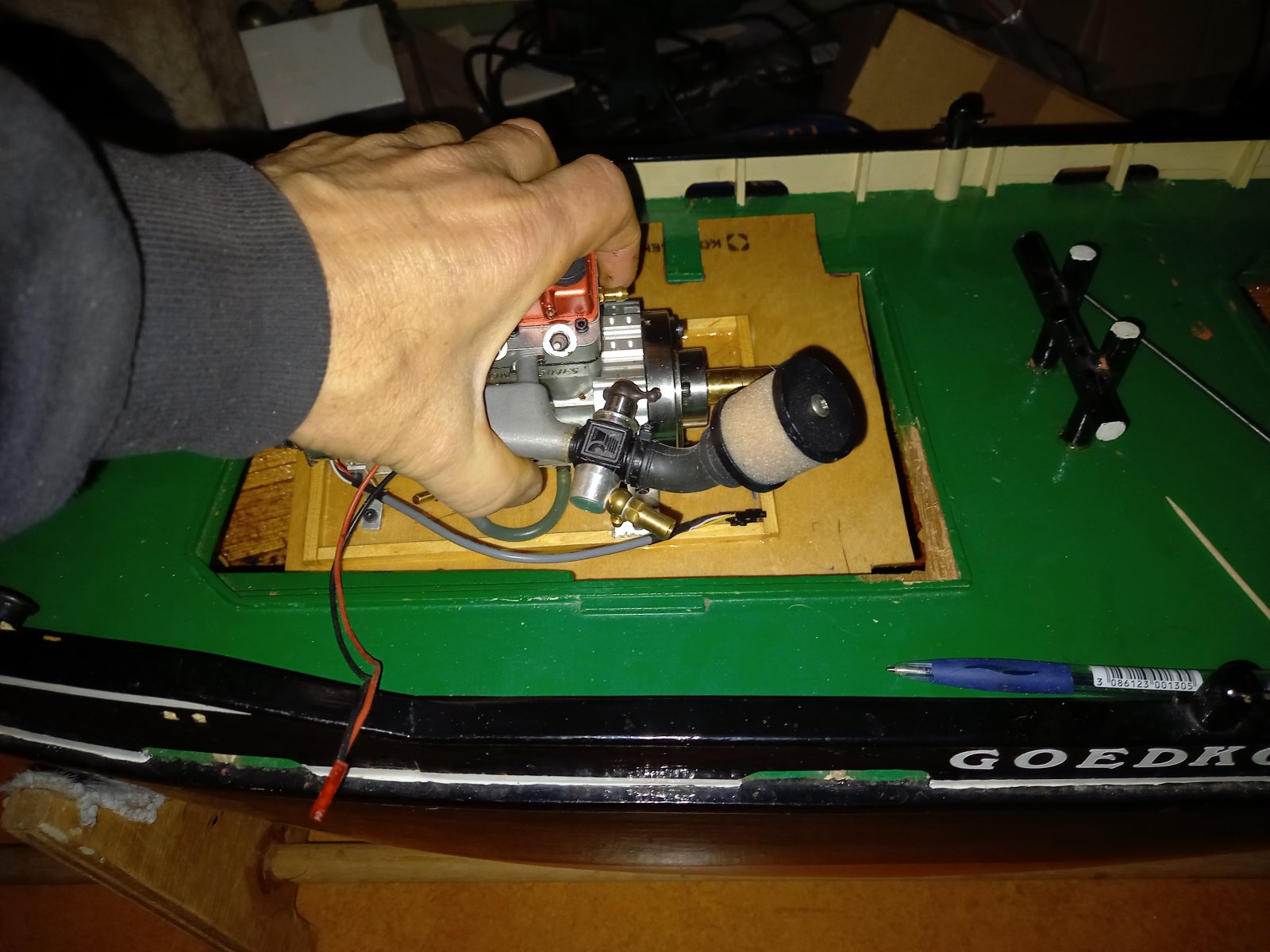

Now, it would of course be mighty nice if the engine could be removed and placed complete with its floorplate, so...
Hmmmm should fit...
ZIG
ZAG
ZOOM
A few simple woodscrews to fixate the floorplate in location should do it, as the engine itself is running fairly balanced and vibration free, but I'll have to think up a convnient tie-down set up.

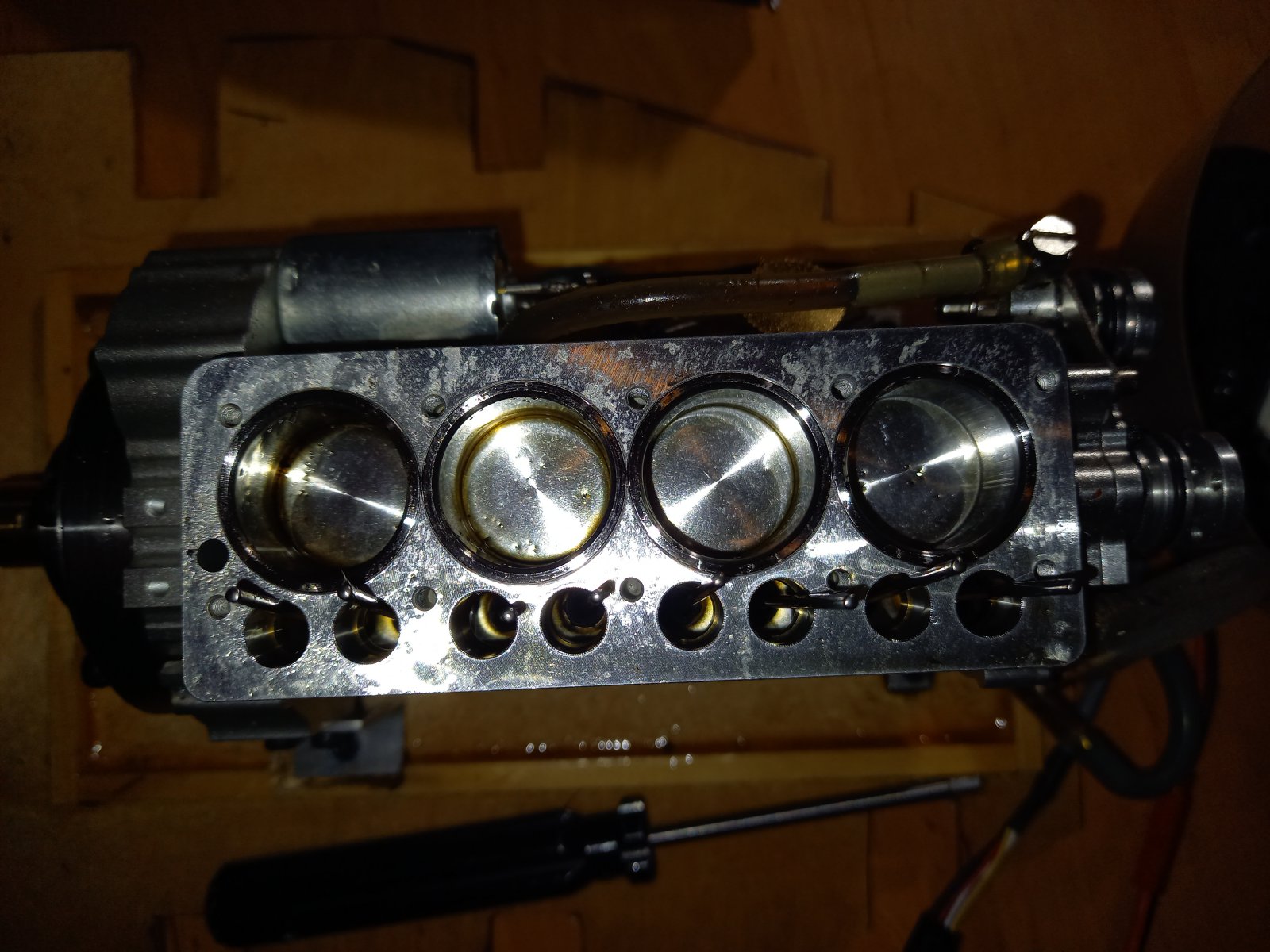

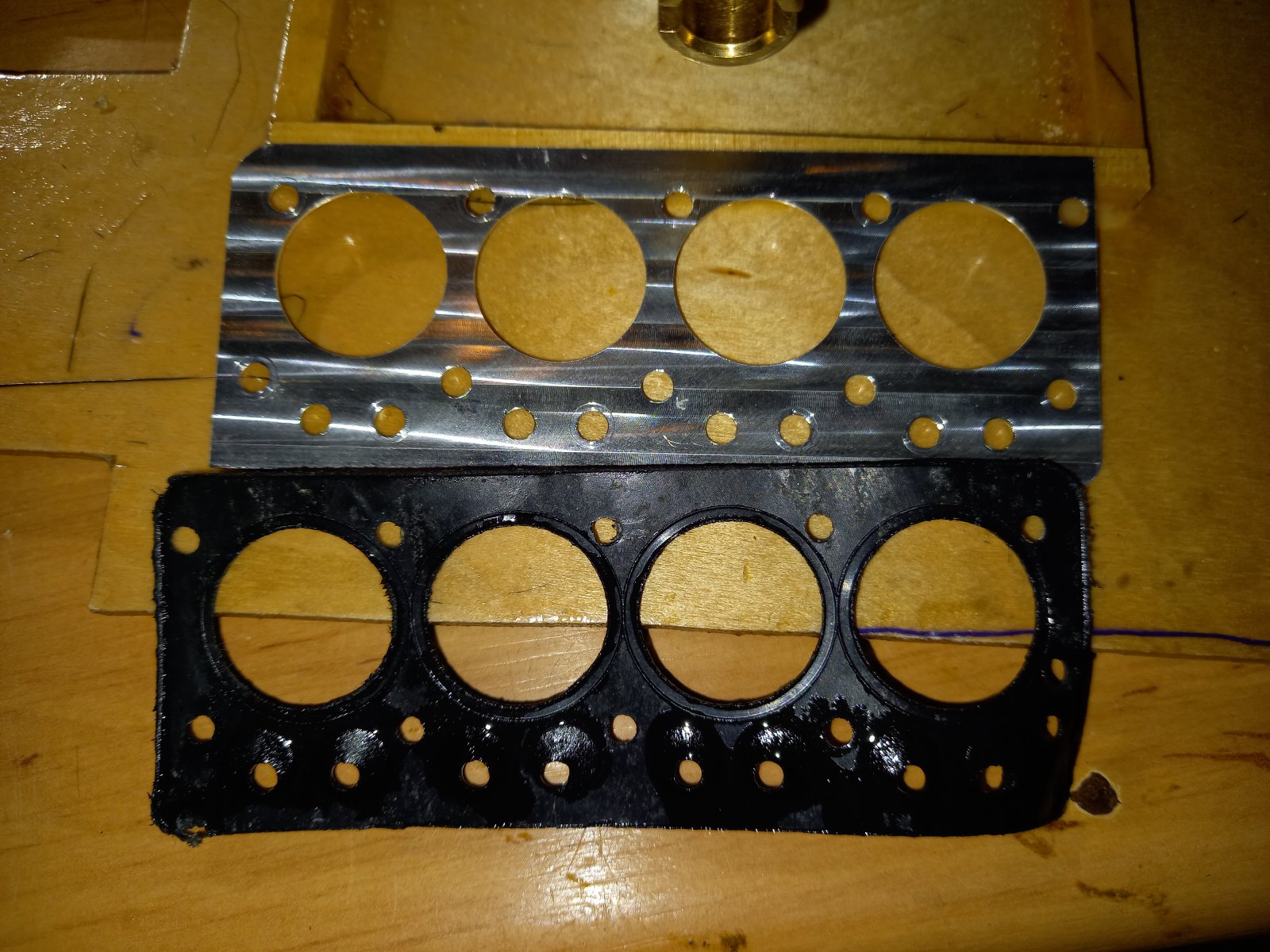

Today again a bit of "mechanics" instead of "shipbuilding"... Wouters main engine needs to be installed, but that involves quite a bit, and what's more, there's also some work to be done on that machine first: One of the things that "bothered" me a bit about the design, was the fact that the cylinder head is not only "completely uncooled" (no cooling water flows through it) but also rests on a non-metallic gasket.
I see two problems with that: firstly, such a gasket will burn away slowly sooner or later, secondly, it forms a heat barrier. The heat is dissipated (it has to, because the temperature eventually stabilizes), but because of that barrier, the temperature of that head is quite high. Up until now, that engine has only run "unloaded", but soon it will of course have to deliver power, and then I don't like that, because replacing such a gasket is difficult, and those high temperatures can lead to warping. A buddy of mine, who is VERY handy with metal, CNC milled a gasket out of aluminum for me.
The idea is to anneal that aluminum plate so that it becomes soft and hopefully seals well.
Of course, a very thin smear of Loctite is also added for good measure. This gives us a gasket that is less sensitive to burning away, and the heat from the head can escape better.
Another advantage is HOPEFULLY, that this gasket will come off undamaged if necessary, because that is the other disadvantage of non-metallic: it "bakes" and does not come off undamaged. Cleaning the gasket surfaces is of course VERY critical, you don't want any scratches here.
Of course, this is a good opportunity to inspect the engine internally, and I was actually quite happy about that: Very little carbon on the pistons, the cylinders are greased on the inside, and no running marks on the linings.
The head showed some carbon on the exhaust valves, I think that is partly due to the experiment with the oil line above the rocker arms (which has already been closed off by the way).
Furthermore, the "cam trough" (actually a misnomer, this is where the cam followers and push rods are located) also looked fantastic.
I am VERY pleased with how the engine looks on the inside, although in all honesty I have to say that the machine has only been running for about 4 hours, and in fact completely unloaded. The times that it ran under load were just with my finger against the flywheel, so relatively short-lived. I am starting to become more and more optimistic in that respect. Now first the new gasket has to be made to fit (one hole still has to be made, which my mate forgot to mill), annealed, and mounted.
