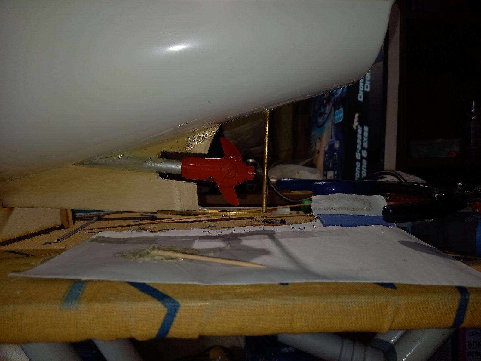

I have checked the bolded, and since I was considering a new and larger project in the future, I decided to bite the bullet and went ahead and bought it.
There was not much choice in sizes anymore, of course, but it turns out it's a hubof 25 mm, and a blade set of 40 mm, totalling a prop diameter of 105 mm, which should pretty much suit my purposes. Most likely going to be a large tugboat, powered by 10~15 cc low revving fourstroke.
Now finding a boat suitable for that propsize.
EDIT: Since that prop and blades most likely spent ages on a shelf at Sussex Model Centre, I figured it would be extremely unlikely that I would rob anyone from the opportunity to buy much needed spare blades, so I also bought the remaining set of 32 mm blades, just in case I can't find a boat suitable for a 105 mm prop.
When things start to take shape, I'll open a separate thread on it.
